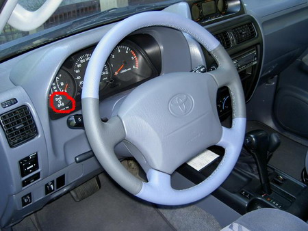

I've got some questions about the 4WD system of KDJ90s.
1. When should work this sign? ( See pic.) Whenever I turn on the ignition, all the wheels are green lighted.
2. Turning into low gear; should I see a warning lamp on the dashboard (?).
3. Locking the middle differential; a yellow lamp and 'VSC off' lights are on. I think, it's okay.
4. How does VSC/TRC work?
