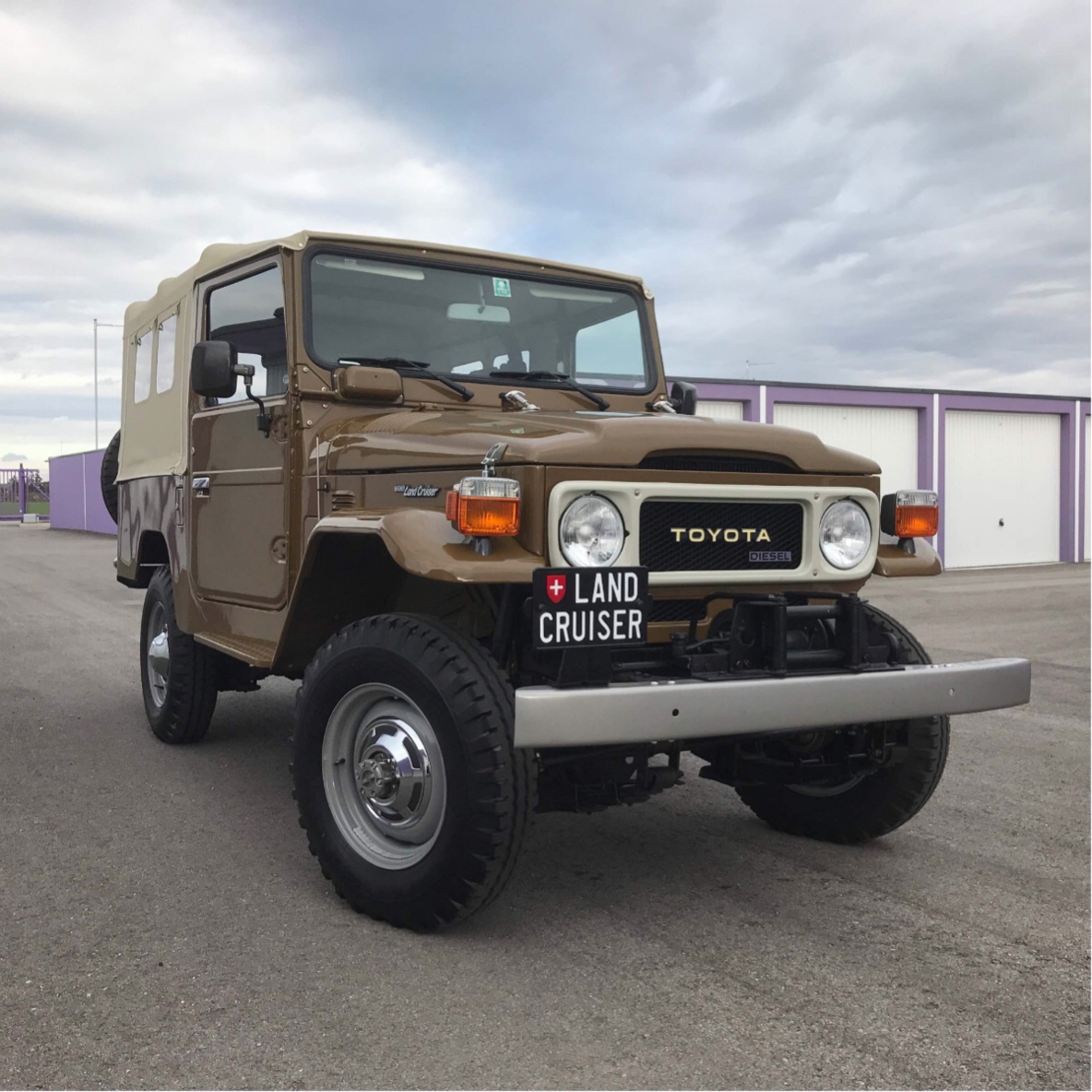

The engine were overhauled in Hannover (Motoren Henze); the body was restored in Berlin; the assamble was done by ORCM (Holger), i just slightly helped them.
The only problematic part was the gearbox, instead of 1 month it was overhauled in 6 months, and looks like not very professional. It's a very famous company in Germany, but i don't want to make a negative PR.

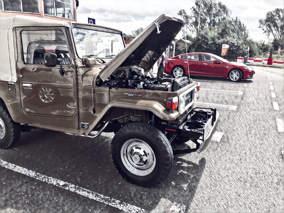

BJ43 vs Tesla
Soenke
Beiträge: 1617
Wohnort: an der Ostsee
Re: BJ43 restoration
Beitrag von Soenke »
Da weiß ich aber welcher nachhaltiger in der Öko-Bilanz ist....und auch noch schöner :wink:

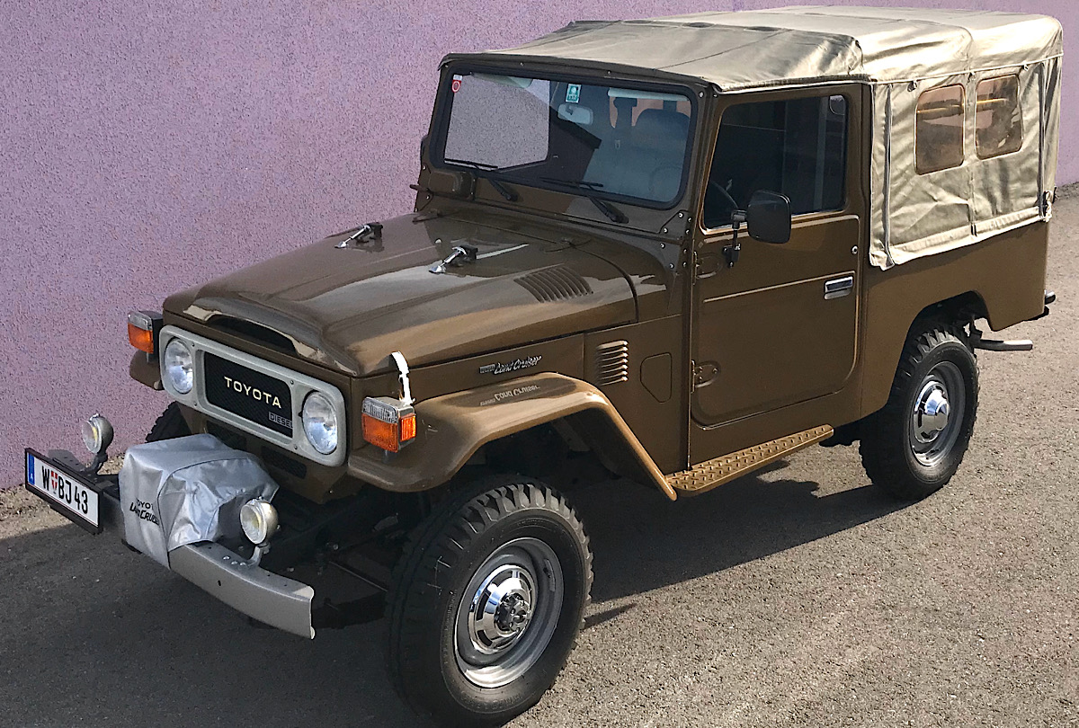

Herbstfotos
Japanischer bj44 Sitz
Stoppelhopser
Beiträge: 96
Registriert: 18. Oktober 2011 17:40
Beitrag von Stoppelhopser »
Hi Mr. Economist aka Mr. Perfectionist ,
Congratulations , very nice truck . I like the details ; hubcaps , backseat , numberplateholder, yes and
the winch ,
Wish you all the best in every way ,
Markus

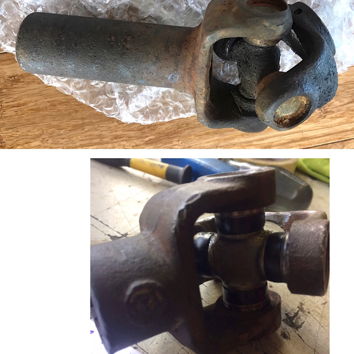

Btw , you got your missing link ?

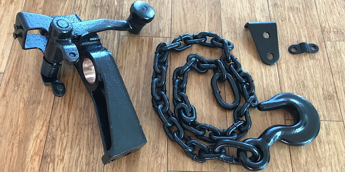

Dear Markus,
I found the long yoke instead of a short one
I also found a nice chain and small parts for my winch
Thanks for your support!

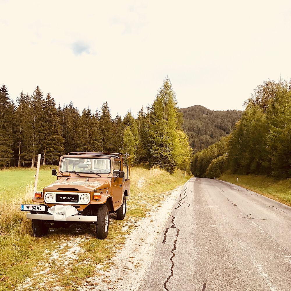

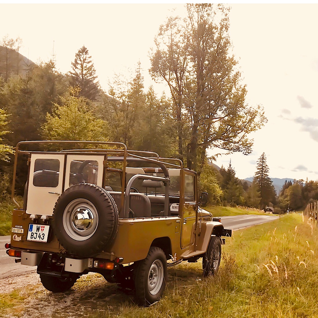

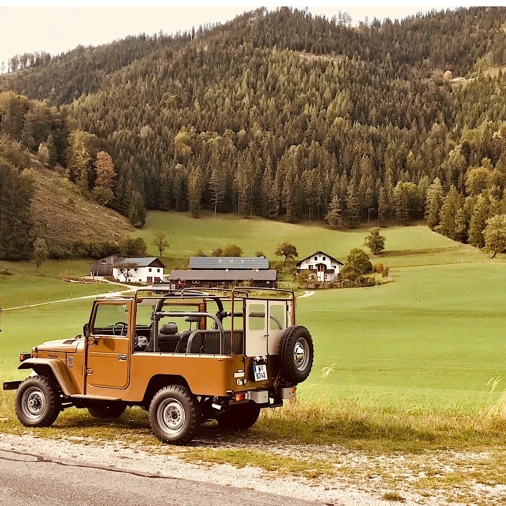

Kurzer Herbstausflug in die Berge

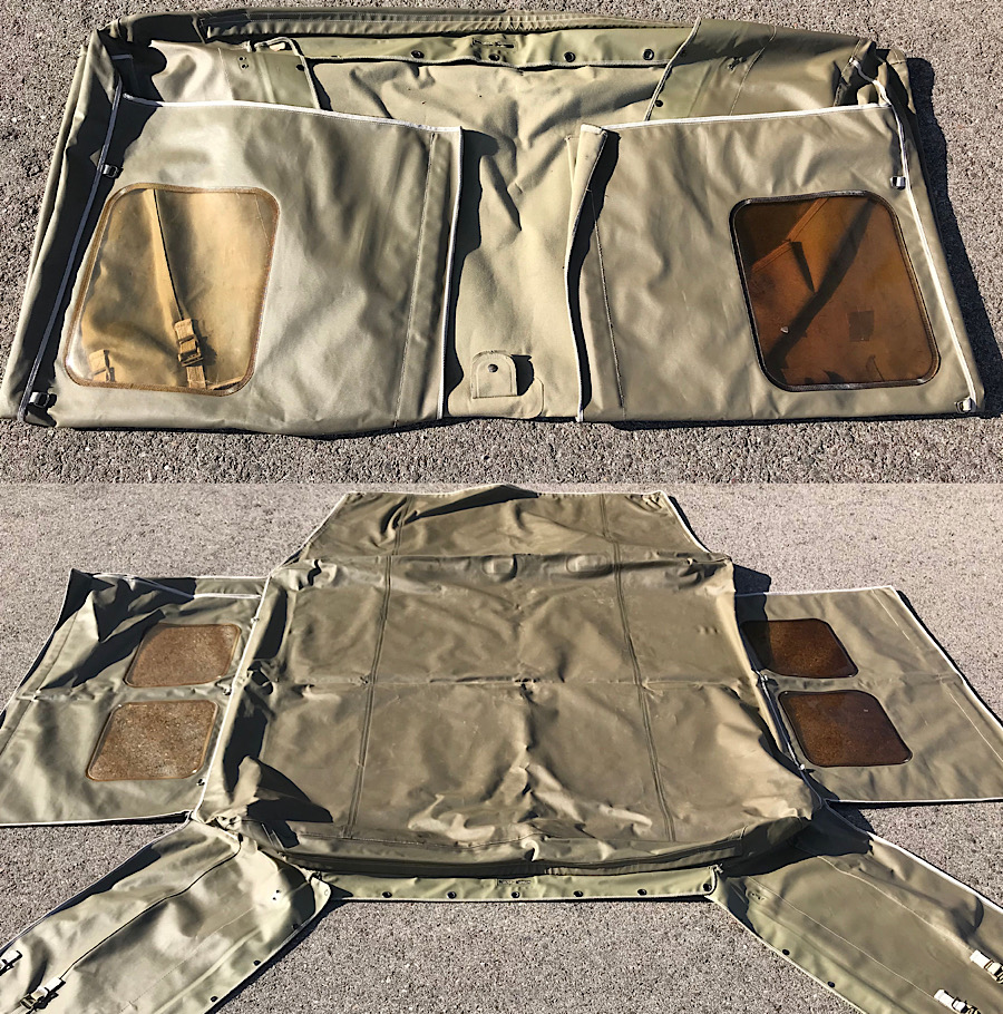

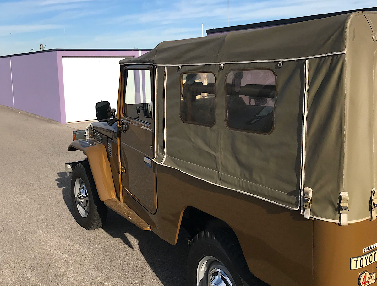

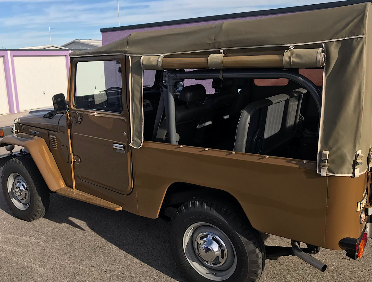

Neues Verdeck (NOS)

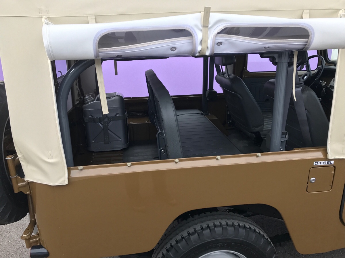

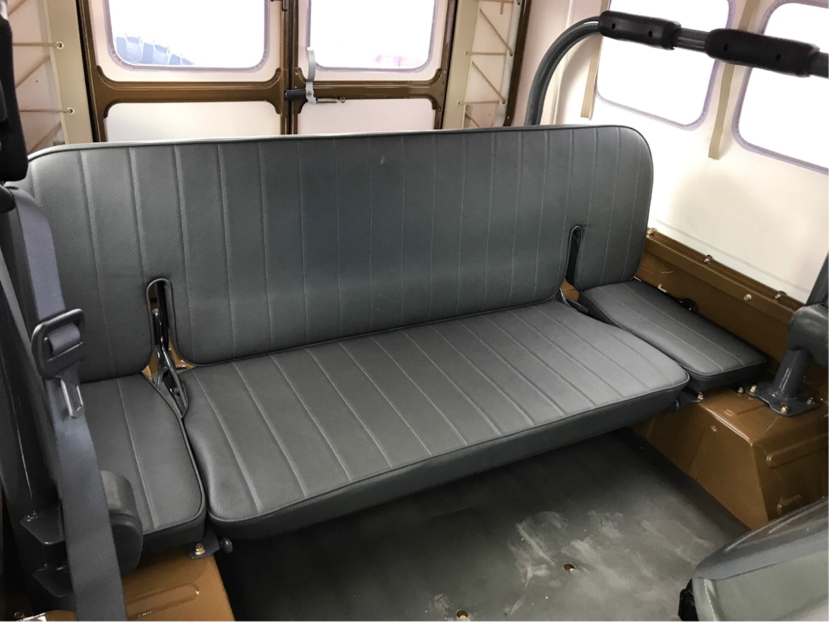

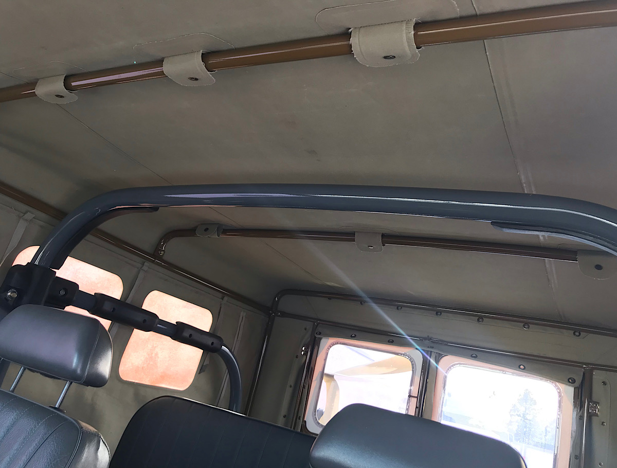

Dear Andrey, as a proud owner of a BJ43 myself, which is heavily used and abused also in offroad trips, I cheer to your restauration. Can I ask you about your rear seat? Where does it come from? Is that custom made?
Cheers, Michal

BJ43CZ hat geschrieben:Dear Andrey, as a proud owner of a BJ43 myself, which is heavily used and abused also in offroad trips, I cheer to your restauration. Can I ask you about your rear seat? Where does it come from? Is that custom made?
Cheers, Michal
Dear Michal,
This type of the seat is from Japanese BJ44/BJ46. It was available in Japan only.
It’s a headache to buy. It’s available on the Japan auctions (buyee.jp), but exceeds the postal limit. I had to find a local person in Japan, send it by ship to Vladivostok, by train to Moscow, by plane to Vienna and by car to Teterow. I would not recommend it again:)
Sometimes it’s possible to see in the ih8mud.com Classified section - rare, not cheap and still to pick up in US.
Regards
Andrey

BJ43CZ hat geschrieben: Is that custom made?
I repainted it to the original grey color (LO11 color trim) and replaced the seat cover - to the front seat style.
